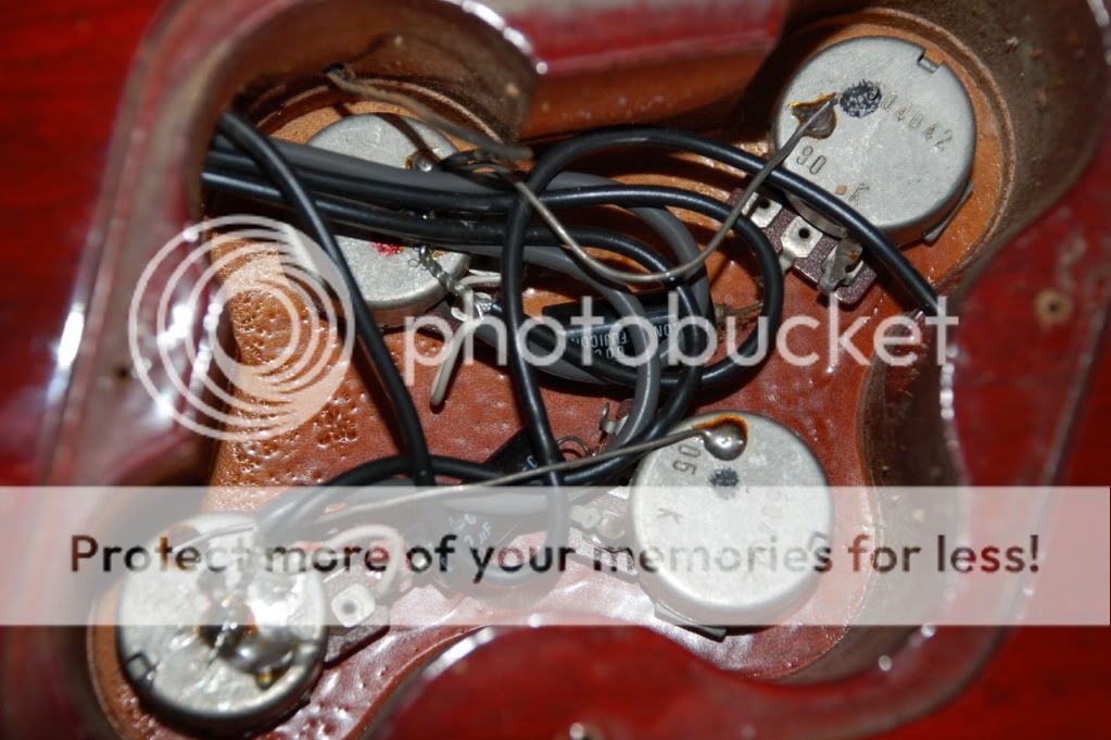

green chicklet caps. grey pickup wires. all original electronics I guess....
rhythm/treble pot stamped M500k0A / 91 k
both volume - M500k0B / 8D k

PostPosted: Mon Jan 03, 2011 9:08 am    Post subject: Reply with quote
I know what you mean. The wavy type starts at least in 1987 but as said these have a different tenon than the post 1990 Burny's. Funny enough I can't seam to find Burny's with 1985 & 1986 pot codes.
Here's control cav pics of 2 1990 RLGs:
Dyna?
Fujigen

That's the wavy control routing I was talking about.
That wavy control routing (top pic) is not what Fujigen was doing at that time (which was more like the bottom pic) and I'm really just left with Dyna Gakki because other routing on these Burnys is not Tokai or Terada and Matsumoku closed in 1987.
