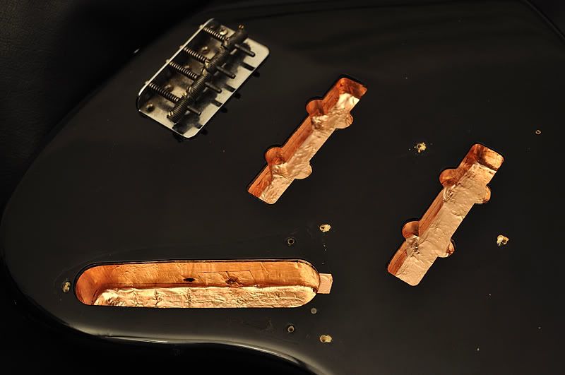

If the humming bothers you (as it did me), your best bet is to shield all of the cavities with copper foil
I've done both of my Jazz Sounds (as well as all of my other basses, including the StingRay with the 'humbucker' pickup
You just have to make sure that the shielding in each cavity is properly connected to every other cavity and grounded (via either the bridge or the chrome control plate) and then the background hum just disappears.
I'm not kidding - my basses are now, to all intents and purposes, silent (when they're supposed to be
) and sound just as clear and bell-like as they did before.
In my opinion, this is the best cheap upgrade that you can make to any guitar and is way better than killing the tone by changing to mud-bucker
pickups! If you spend thousands on a 'boutique' bass, you usually get great shielding as standard, but for the manufacturers of 'standard' basses, the work involved represents a scary percentage increase on the price tag, which is why even the mighty Fender corp. don't bother to do shield cavities on their 'normal' basses, IMO.
Get yourself some self-adhesive copper foil from ebay and give it a go - you won't regret it
