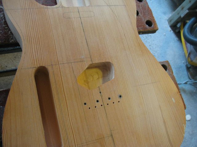

Today I bolted the bridge on the body;
To allign it I stretched a line from the middle of the nutslot to the butt of the body, centered over the neck. Apparently during neckmounting centreline has shifted somewhat so that's why it looks the bridge isn't positioned right.
Bolted down the bridge and used the holes to centrepunch the locations for stringthrough channels;
Those aren't absolutely straight, can't rely on this Wilkinson bridge to be straight. I knew that ahead of time, don't worry, it'll be OK.

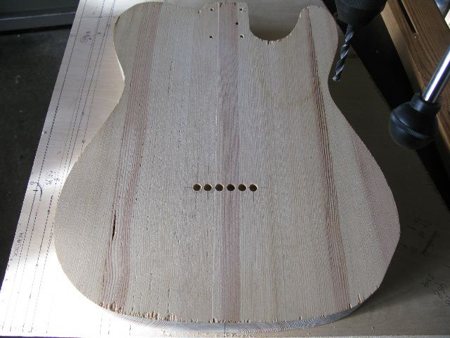

These 6 locations got drilled halfway through the body. Then used the IndexPin to locate the two outermost holes. Put the bridge on and used two nails (same diameter as the holes in the body) to secure it;
Again used the holes in the bridge to mark the other 4. I know, I know... they won't be 100% straight, calm down. It'll all be OK in the end (here's to hoping eh?);
Being stubborn and headstrong I drilled through all the way to the holes on the other side and waddayaknow... they all hit home!;
I failed to shoot a pic of the light coming through the holes cuz it's a bi-atch holding the body to the light and pointing the camera, but if anyone insists (and I know someone will...) I'll do my best to please you.
Tomorrow I'm 'constructing' the jig I have planned to allow me to drill for ferrules abso-friggin'-lutely straight. I'll be testing that contraption on scraps first. Fingers crossed please...

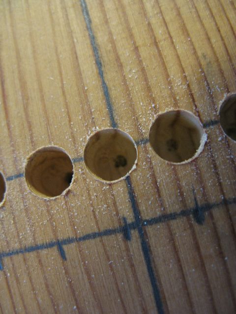

Got home, took a scrap from the box, drew lines and positions, taped to the 'jig' and went for it;
Hmm, they're straight, just off the line... wuzzup with that? Oops, didn't clamp the fence right.
OK corrected that;
straight and on the mark. Well, here goes nothin';
Worked! here's a close up;
=phew=

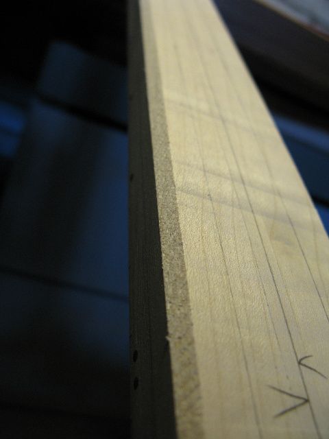

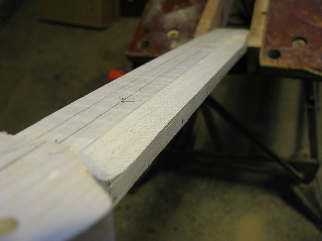

Some sanding to make for a little smoother surface to be able to mark a new centreline and divide the neck into 4 segments;
Divide the side of the neck into two;
Same for the other side of course.

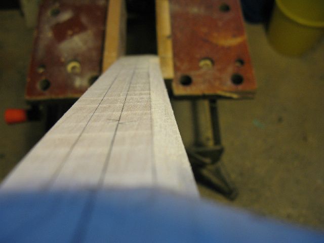

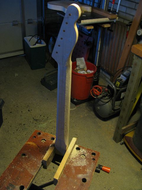

Then clamp the neck to be in a vice or a workmate, using scraps to prevent indentation;
Ready to get out the ole' rasps!

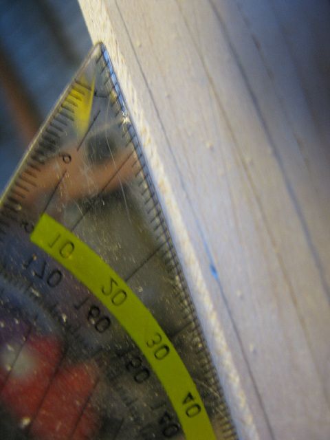

This is when I get in a good position and make sure I have plenty of light (preferably sun) on the workpiece. I want to be able to see the back of the neck and one of the sides so I can keep an eye on the lines I drew. The object is to rasp away all wood outside those lines.
I will try and maintain the same angle on the rasp while taking off "all the wood that isn't a neck".
This is to show the cut should be smooth and straight all along the segment that's being taken off. I'll take more off;
You can the cut isn't exactly parrallel to the line, there's a little deviation, easy fix.
I check with a straight edge piece every few passes to see if I'm still in line and if the face I'm cutting is straight;
The more attention I give to the neck at this stage, the less work I'll have getting it smooth later on.
After a while it should look something like this;
Those tiny little deviations I'll sand out with a block after I've done the other side of the neck;

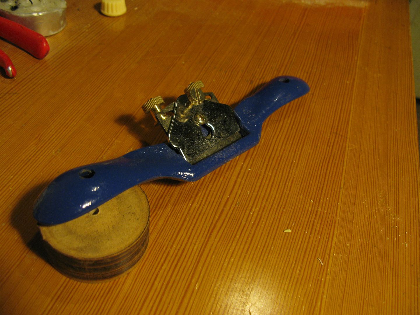

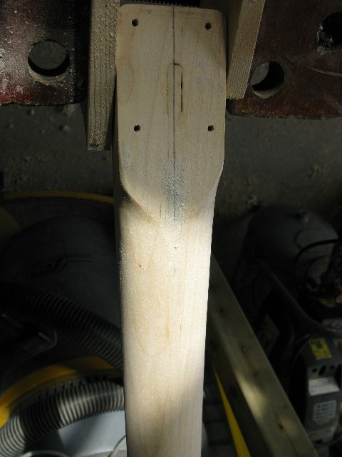

Marked more area I want to take off;

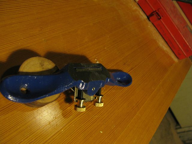

Time to get the spokeshave out;
Mine is a cheap POS but it does the job;

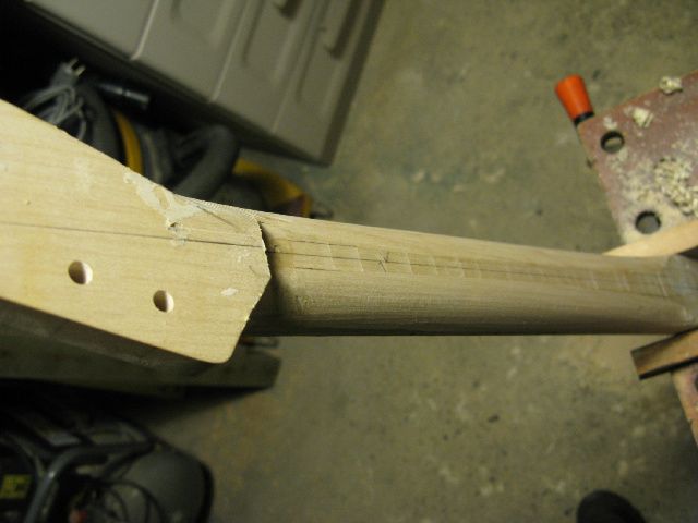

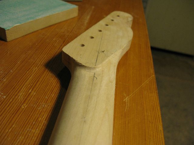

Starting to look like a neck, still doesn't feel like one, gotta take off some more;
Transition needs some more work but I think we're almost there;
va' sa' du? va' hete' du?
JuniorEnthousiast
Joined: 26 Dec 2008
Posts: 316
Location: ?cker?'s loge
PostPosted: Mon Mar 12, 2012 10:27 am    Post subject: Reply with quote

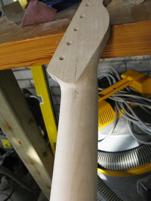

You probably don't even see the difference in the pics, but now I'm happy with the profile. I see a whole lotta sanding coming.

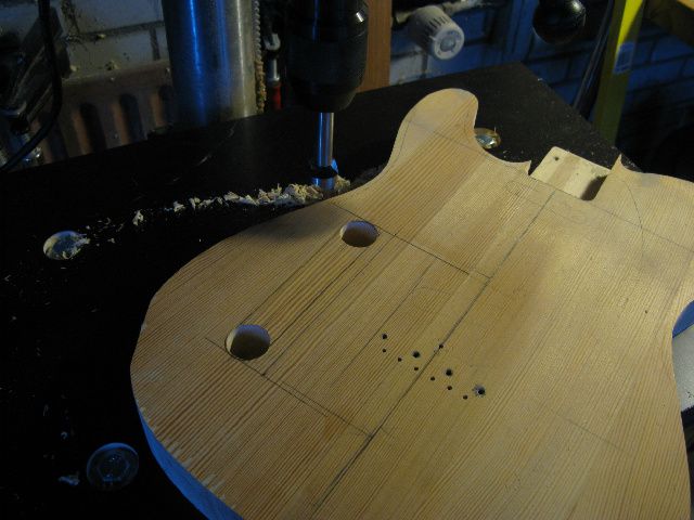

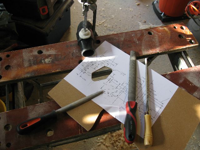

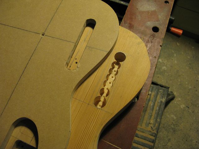

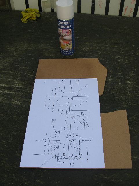

Had some time to spare, so I made a template for the bridge pickup;
Hogged out the cavity using the drillpress;
Slapped that template on;
Voila;
