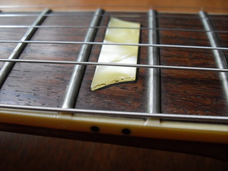

Just got my Orville by Gibson 59 RI and found that 2 of the inlays are popping out. Seems like this might be a bit of an issue with Orville's as I have heard this before. How difficult is this to fix? Is there a special glue that is to be used?

Yeah my OBG did that too but good old Kobayashi sent me some spares he had (love you man!! lol)...a few of my MIJ's are like this. I have used thin model glue with success but you can also use Gorilla Glue or even wood glue if the area is cleaned first.

Was it difficult to remove the inlay without breaking it? I am scared that the inlay will crack when I remove it.

Best way is to lay a towel over it and use an iron for about 5 secs...that will heat it up and you can they just pull it off effortlessly.

Good tip; thanks.
