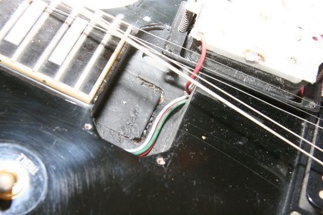

Hmmm, this one is very interesting, it has had fret binding but been refretted, you can still see whats left of the fret ends.{binding} and it doesn't have the Tokai route it is a square route like the fujigen route but.....it has unshielded wiring and black shielding paint...Any ideas???
i'll post pics later

I know what you mean. I've seen 3 different types of no serial Grecos. There are the Tokai ones that are easy to ID and then there are the Cort ones that are easy to ID with Cor-Tek pots and usually have shielding paint and then there is another type that has things in common with the Cort Grecos like the rectangular long tenon and the brick nut but also has some differences. I think that these are made by Cort but I'm not 100% certain. They do have the rectangular long tenon and same sort of control routing as the Cort Grecos. I think Cort changed the way they made some Grecos and did not stick to making them one way. All of the no serial Grecos are very different to the stamped Fujigen made Grecos. There are still a lot of things about the Grecos that's not understood properly. Grecos went through a lot of changes over the years. Kanda Shokai who own the Greco name are the distributors for Cort in Japan.

That one is very similar to guitar.sib's one above. Rectangular tenon like the Cort Grecos but the pickup routing is a bit different, I'll guess Cort.
