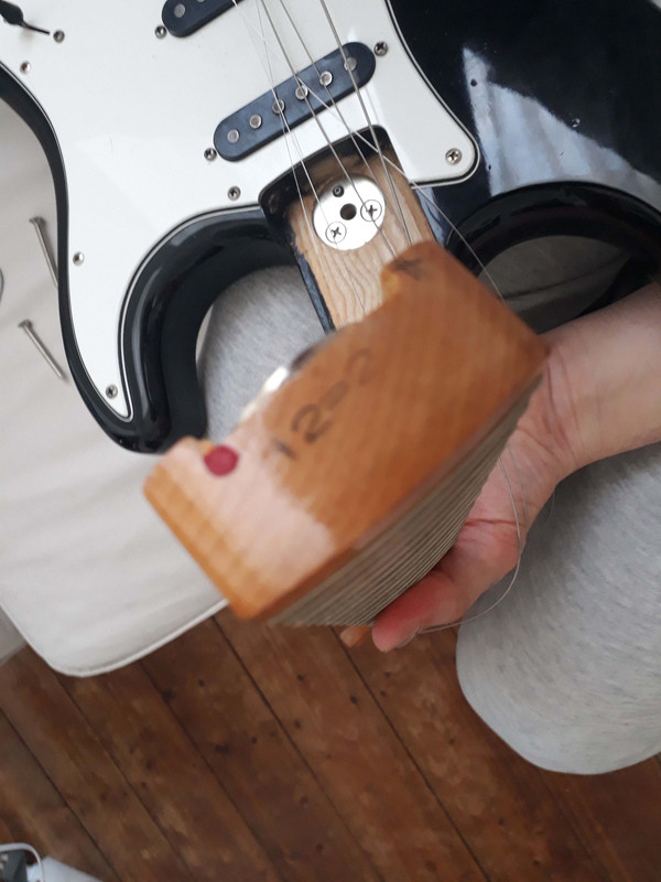

It would appear that the neck has indeed been swapped. The numbers shown on the neck compared to the body are too far apart to have been done at the Factory. Can you post a pic of the bottom base of the neck please. There should be a round metal disc screwed on there.

PostPosted: Fri Aug 09, 2019 3:16 am    Post subject: Reply with quote
hey peter,
i read about your accident on the other thread. get well soon!
here are the photos of the neck. the metal disc is there. there's also one on the neck pocket, so one lay on top of the other. what exactly do the numbers (12=2) refer to?
just realised that the second photo is a bit blurry. but it says 12=2 and there is also three lines written with a pencil on the top right corner of this side of the neck. like: ll and then one line crosses that.
