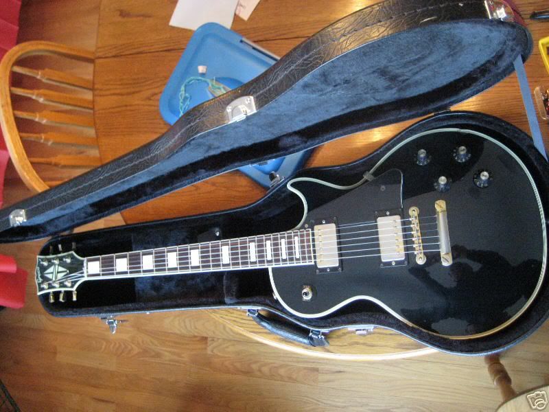

I'm also sure that Burny is a Matsumoku made. My Aria Pro II Leopard have exactly the same kind of tenon and routing like guitars Matsumoku have made for Aria Pro II.
This is not the first one I have seen. I have seen another RLC60 with the normal diamond in Black colour sold on ebay.
Matsumoku made some 3 pieces neck for Aria Pro II Les Paul models, especially for the custom model.
And last, but not the least, the inlays of this Burny are getting old like the Matsumoku Aria Pro II LP inlays...
