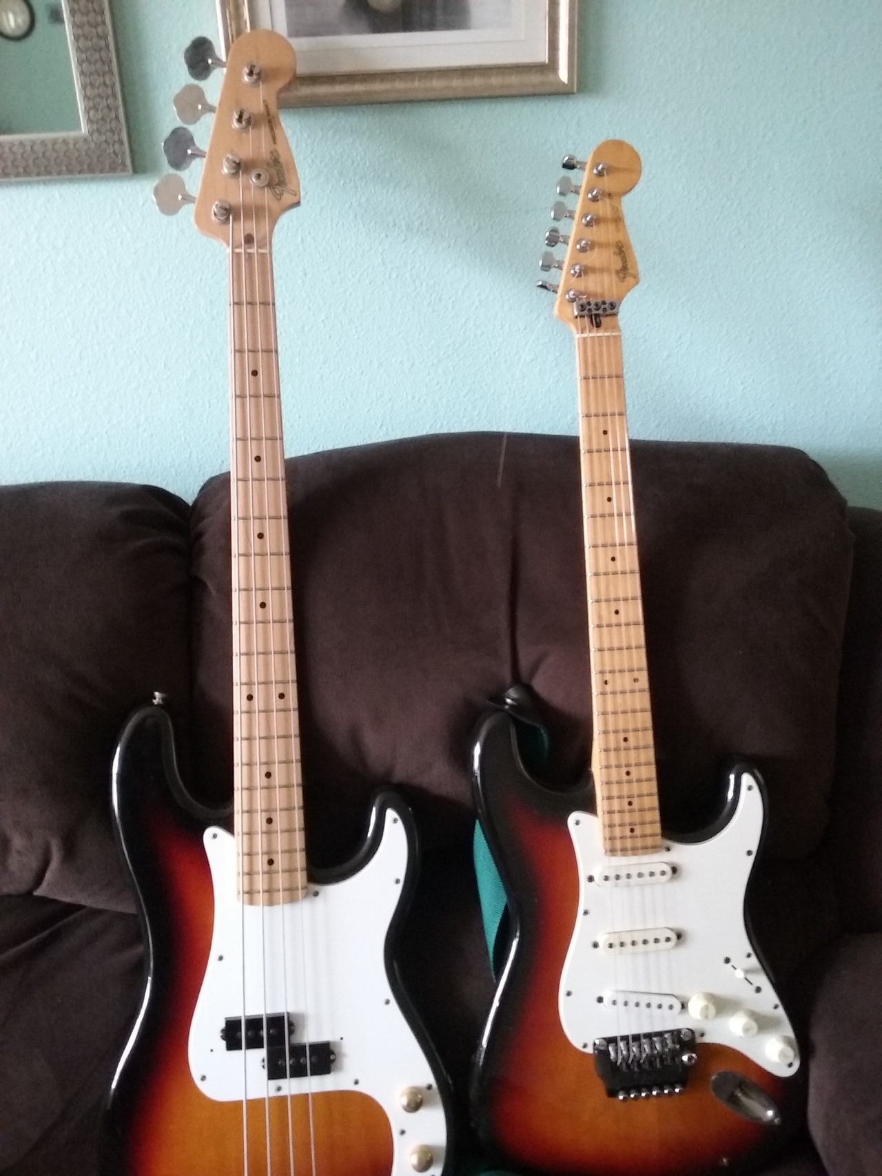

I know the 80's Fender Contemporary Strats have the 12" radius. Love it!
I could do without the System 1 trem, wish it had a standard trem.
Stays in tune with dive bombs but doesn't work for subtle vibrato like a standard.
