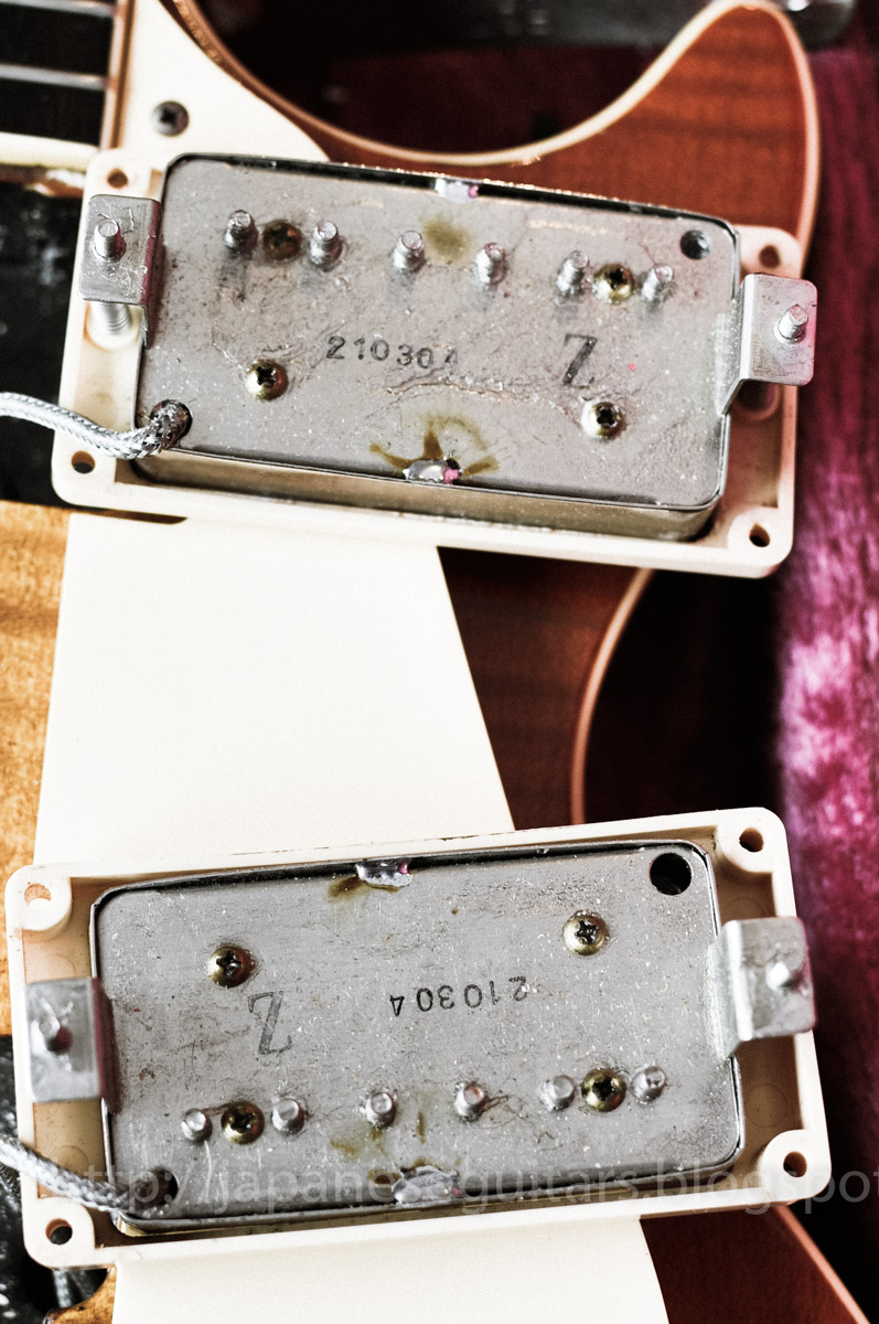

Those look like fakes to me with the incorrect Z stamp. There are a suspicious sets out there like this one (https://page.auctions.yahoo.co.jp/jp/auction/u228354497) with the square bobbin hole which is not seen on DRY Z pickups.
Posted: Sun Nov 11, 2018 6:49 am
by guitar hiro
Hopefully whoever bought the set on YJ didn't get ripped off
interesting observation Harold about the Z stamp; I wonder if any of the Zs I've owned had a 'fake' Z stamp? :o
Is there a way to tell if the Z stamp is legit, or 'fake?'
Looking at the Z stamps in the two above links I can't really tell any difference; is there something that gives away a 'fake' Z stamp that most here would not discern?
Also, some of my Dry Z pickups have serial numbers that start with the number 2 & some start with the number 8
Yeah, the sets I have owned only had the two round holes; not the third square hole which is an attribute of the (later) Mint Collection era pickups.

It is not myself who bought them but, to be honest, everything seems legitimate for me. Square holes and everything. The first set has the Z a little thick, it's true, but it seems to be due to the movement of the hand, not to the false stamp.
It's just that the prices of these Dry-Z are rising inexorably, given their scarcity and quality.
Why? Because even if today we buy a set of K & T supposed to be at the same level, it's not true, Dry-Z are above. It's only my opinion, of course.
Posted: Sun Nov 11, 2018 7:55 pm
by guitar hiro
Dalko wrote:It is not myself who bought them but, to be honest, everything seems legitimate for me. Square holes and everything. The first set has the Z a little thick, it's true, but it seems to be due to the movement of the hand, not to the false stamp.
I would take exception to the 'square hole' theory as far as the Dry Z examples are concerned.
I know of no Dry Z examples with the third/square hole in the bobbins.
IMO it is (somewhat) common knowledge the early DRY 1982 examples also had the two holes in the bobbins, sans the third/square hole.
Please, anyone with early DRY 1982 examples that are an exception correct me. Thank you

Maybe you're right. I just saw now, after enlarging the image, the third "Square hole".
There is a doubt about it. It reminds me of PAF: http://www.guitarhq.com/paf.html
In the same time, the "Z" on the pickup baseplate is correct.

IMO the Z is not correct, there are subtle differences. Good attempt though. Here is a picture of Z's in a guitar. Note how narrow the ends of the letter are. It CAN be smudged or have variation due to stamping but IMO buyer beware these days.

wulfman wrote:IMO the Z is not correct, there are subtle differences. Good attempt though. Here is a picture of Z's in a guitar. Note how narrow the ends of the letter are. It CAN be smudged or have variation due to stamping but IMO buyer beware these days.
It CAN be smudged , and IT IS A LOT OF TIMES with Dry Z's.
To me, it's just impossible to say that it is a fake because it is a little stained or there is a little more ink ...
Just have a look on this Dry-Z-S:
From EGF-1800 here: https://www.ebay.fr/itm/1980-Greco-EGF- ... :rk:1:pf:0
The "Z" stump seem to be correct to me. For ALL the examples we saw here.
Don't know for the third square hole.
Who knows what is under each pickup cover of dry z's in 1981?
Hi Harold, I certainly agree with your point AFA "buyer beware" when looking at the overall set of attributes when considering the purchase of most any item, Dry Z pickups included.
Take for example the link you provide in post #2.
The base plates look legit with one of the latest serial numbers I have ever seen for a Dry Z.
You mentioned the third bobbin hole which I agree is a huge red flag for a Dry Z example.
The screw heads are also wrong; they should be single slotted.
I guess we can agree to disagree on the Z stamp itself, as I have had examples that have some variance within matched sets.
I have also seen this 'font variance' in multiple photographed examples, as Dalko has also provided.
AFA the example you provide in post #2: I believe the base plates are legit BUT I believe someone switched out the actual pickups & attached a different pickup to the Dry Z base plates.
AFA the set in the OP link there are two things that stand out:
The serial #s are one of the earliest I have seen for a Dry Z.
The claimed meter values of 7.87 & 7.97 are a bit higher than most reported 'nominal' values but are still within noted & reported values.
None the less likely the highest values I recall for a matched set.

I should have mentioned that the seller with the 3-hole bobbin set also sold 2 more sets recently, all with non-original covers. Not conclusive evidence, but there are tons of Maxon/Fujigen pickups out there to use if a person wanted to make a few sets. All they would need is a similar "Z" and number stamp.

Can I just jump into this thread with my example of a set of Dry Z (or not). I bought a set 10 years ago from a well known Japanese guitar dealer on this site. They look identical to the ones posted by Wulfman in post 2 with the two round holes and the third square hole at the edge. They also don't have pickup covers (obviously otherwise I wouldn't be able to see the bobbins). It's been so long since I've seen the base plate that I honestly can't remember what they look like, though I'm sure they had the Z stamp. They do have the slotted screw heads for the height adjustment though, rather than the Phillips head - but this could be simply something that has been replaced on the example pickups and I wouldn't put too much stock in those (they have been knocking around for nearly 40 years after all).
I will say that they sound fantastic, and I have another set of Dry Zs in a 1980 SA-1200 to compare them with and I've never felt that they weren't genuine before reading this thread.

It would be interesting to see ALL attributes of the three hole bobbin examples you speak of: the Z stamp, the serial number stamp, etc.
Screws can be changed, easily.
